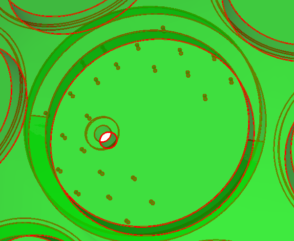

Hi @ChadJames,
it looks to me like there are some unnecessary holes still hidden in the volume. Do you need them?
grafik
Yes. these are to the nTOFs lines-of-sight 10’s of meters away. Is this causing the problem?
Do you currently still get an error when you want to mesh?
When i delete your mesh and mesh the geometry again, i don’t get an error that prevents cubit from finishing.
