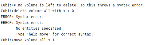

I am getting a syntax error, when trying to delete volumes, that do not exist.
Is this a bug or working as expected?

delete volume all with x < 0
delete volume all with x > 0
# no volume is left to delete, so this throws a syntax error
Hello @ThomasUtz,
i think that is working as expected.
It probably should also state that no entities are specified, like it does for trying to move non existing entities.
When trying to delete a specific non existing id you would at least get the info that i was not found.

You could try to “catch” this with using the python api.
