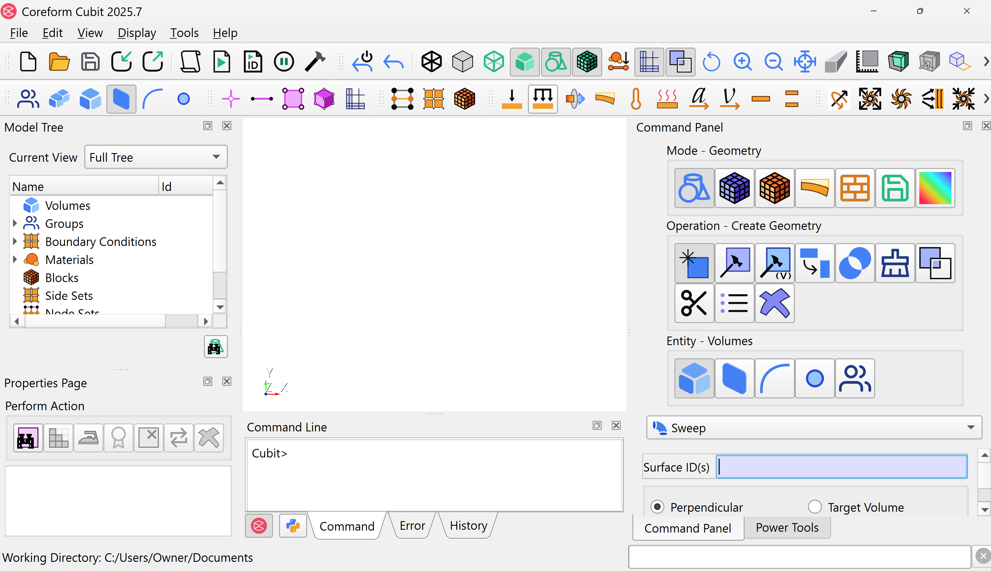

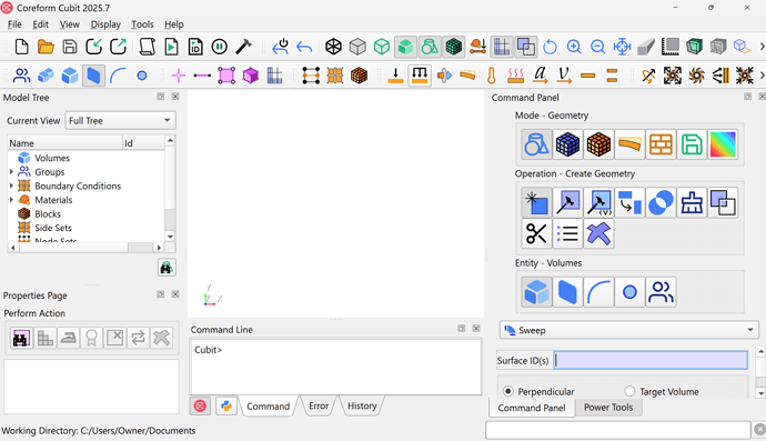

GUI library upgrade: Qt5 → Qt6
This is probably the largest, most complicated upgrade in this release candidtate. Some of you are probably aware that the Coreform Cubit GUI is based on the Qt Framework, the latest version of which is Qt 6.9. Coreform Cubit has been on Qt 5 for quite some time, but Qt 5 is in its “End of Support” stage. We’re excited about this upgrade as it will allow us to provide a slew of new capabilities to users in later releases and provides improved support for modern desktops.
How to test:
We encourage testers to really hammer on the GUI to see if you notice any critical issues that slipped through the cracks!

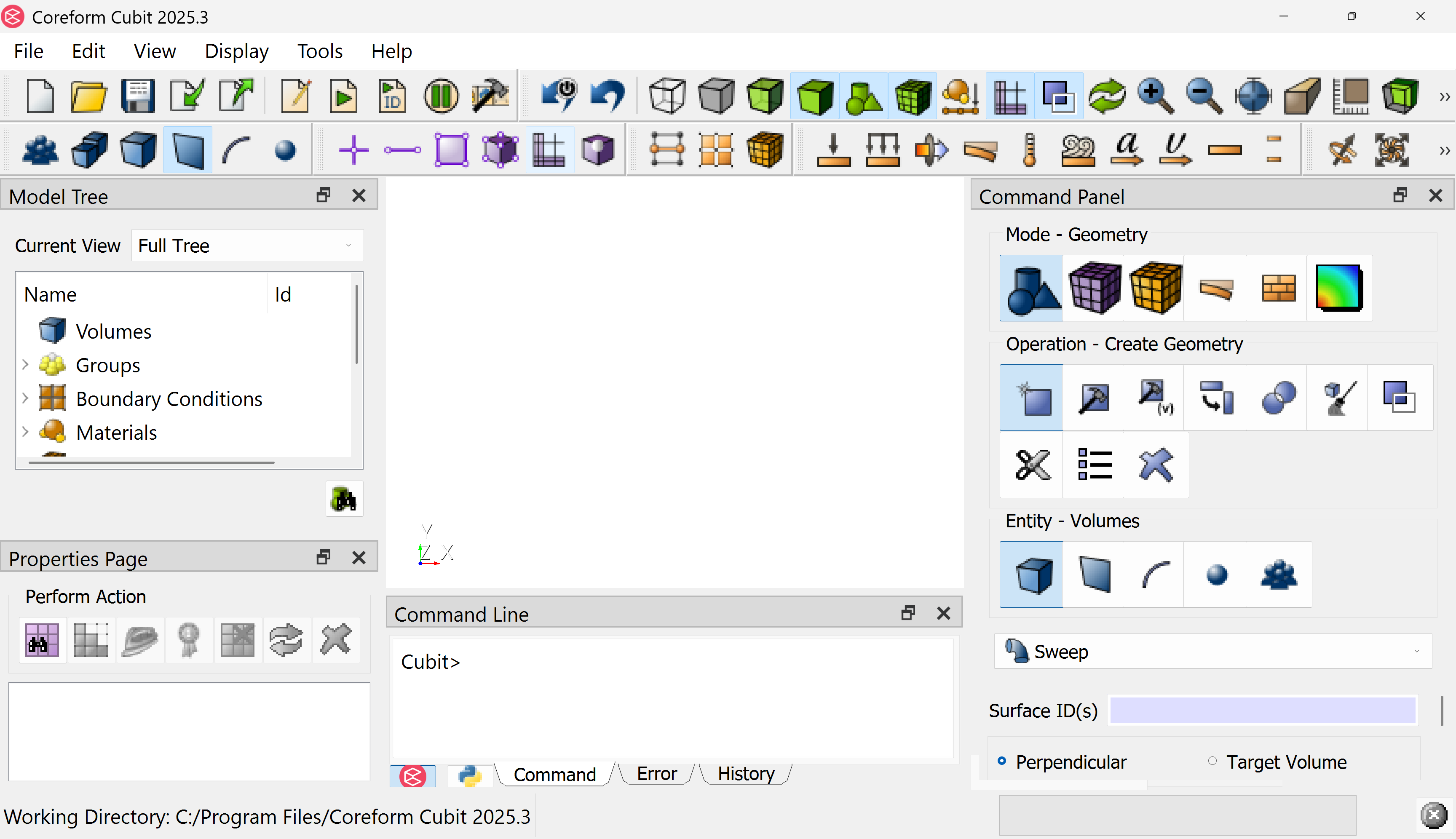

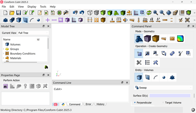

New, scalable, icons
Many of our users have high-density pixel (HiDP) displays which exposed all the ugly pixels in our PNG-based icons. While largely a cosmetic issue, by redesigning these icons as scalable vector graphics (SVG) we feel that the new icons result in a cleaner user interface and are more user friendly for those with HiDP monitors and laptops.
Old
New
How to test:
- We encourage testers to really hammer on the GUI to see if:
- We’re missing any of your favorite icons!
- Any of the icons don’t feel “hooked up” to supposed functionality

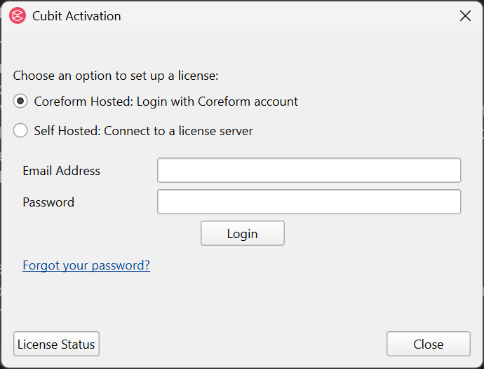

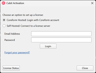

- Launch Coreform Cubit release candidate (installed via links above)
- Choose the
Coreform Hosted
option when prompted to activate a license:
- Fill out your email address and password that you currently use to login to our current license portal. If you’ve forgotten your password, you can reset your license by clicking on the
Forgot your password?
link, which will take you to our new license portal (see section below).
