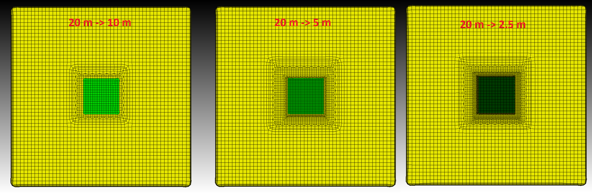

I am using adapt_type in Sculpt for refinement of inner material (volume 1) inside other material (volume 2). The mesh size in volume 2 should be 20 m and I want to have mesh size in volume 1 of 1.25 m.
I was able to pass from 20 m -> 10 m, 20 m -> 5 m & 20 m -> 2.5 m (see the attached Figure).
However, I cannot reach 20 m -> 1.25 m, please see my input files.
Is there a limitation for refinement in Sculpt?
Thank you very much for help.

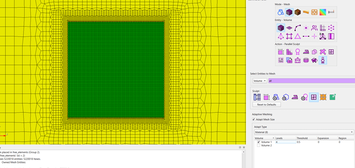

Your second input adapt_material = 1 *3* 0.05 0 1.0 defines the refinement level for the uniform refinement. So you are requesting only 3 levels of refinement.
I did run 4 levels of refinement successfully but sculpt used up to 40 GB of RAM for it. By the way, the easiest way to run sculpt and set its options is to use the gui in cubit.
