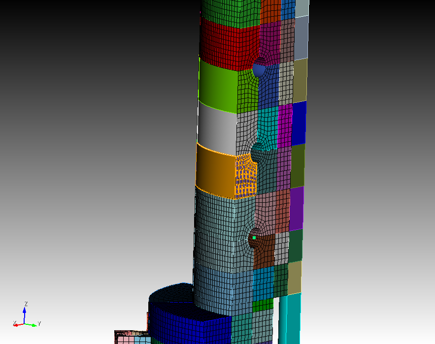

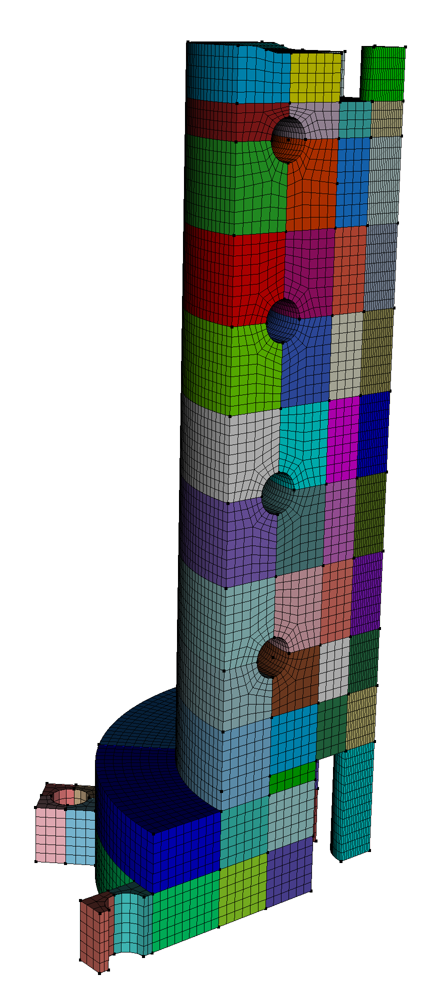

In the following test (well known geometry :laughing:), i do not understand why in cannot mesh the volumes 67/60?
I tryied to impose a discretization with a number of intervales of 23 onto the remaining curves, but it does not work:
  • is there any remaining constraint?
  • am i missing something?
    (typical issue i can be faced on .. i guess)
Paul
ERROR: Matching intervals <<< UNSUCCESSFUL >>>
ERROR: 1 volume did not mesh : Volume 67
test.cub5 (7.1 MB)

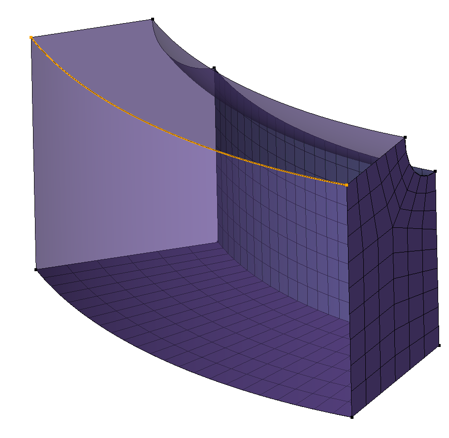

There’s no need to impose such a discretization on those remaining curves. Because those volumes have sweep mesh schemes, the linking surfaces are going to be mapped meshes. And since the volumes above and below are already meshed they’re already constrained. So applying an additional constraint will lead to an overconstrained system.
For example, here’s volume 67… see how it already has two linking surfaces that are meshed? Trying to enforce a hard interval on the highlighted curve will result in an overconstrained system:

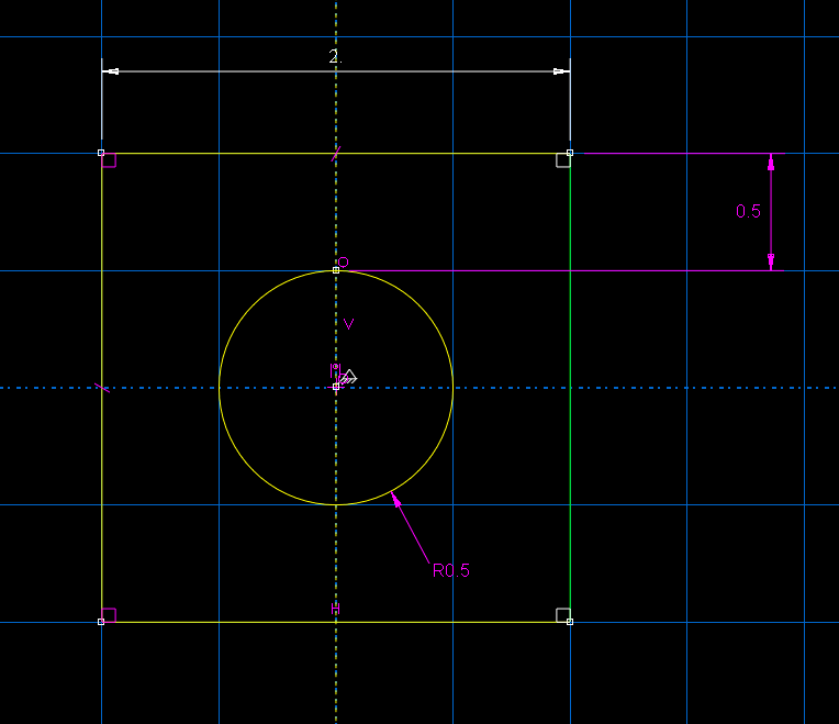

Even though you’ve set the interval count to be the same as the number of intervals on the meshed surfaces’ curves, this still results in an overconstraint similarly to how this sketch, in a parametric constraint-based sketcher, is overconstrained:
